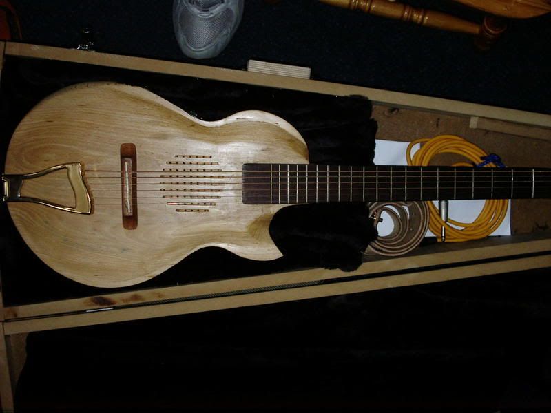

I mentioned the Acoustic Les Paul which I built before Sam pointed the way towards this fine place
and SOME of you seemed not to understand the concept.......

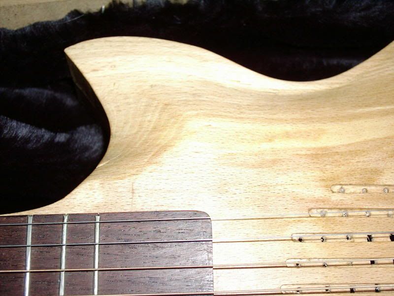

Yes it IS (vaguely) Les Paul shaped.
Yes it IS acoustic!!!!

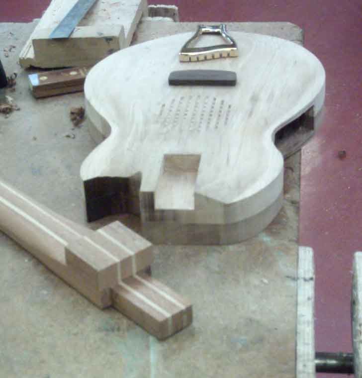

The body is a clamshell made of a 40 yearlod mahogany bench from a school science room and a big old plank of beech

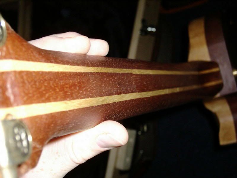

the neck is a mahogany sycamore lam tenoned in with epoxy (scarfed headstock)

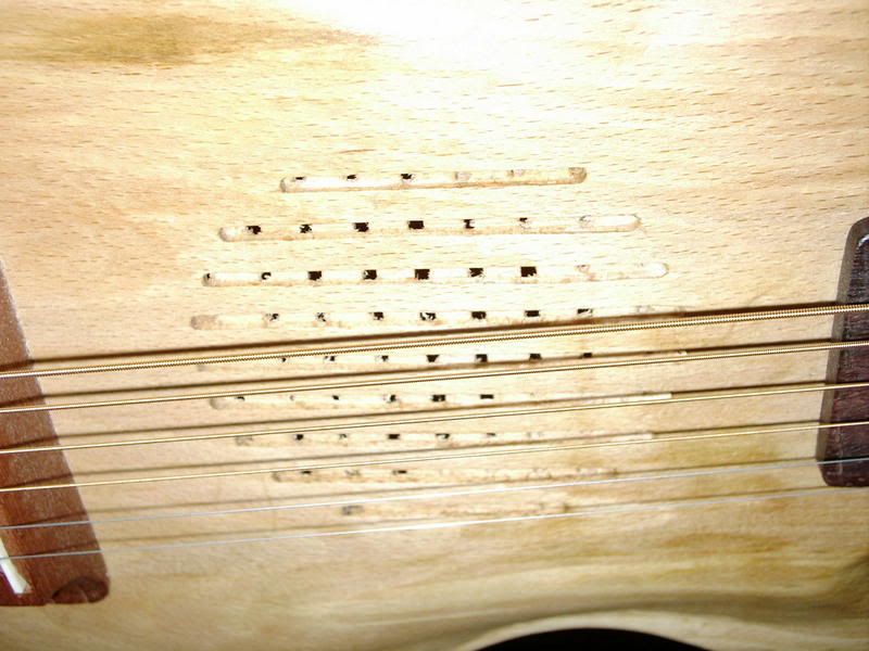

The soundhole is a series of slots cut at 90 degrees to eachother 2/3 of the thickness of the top....
giving the lattice effect.....

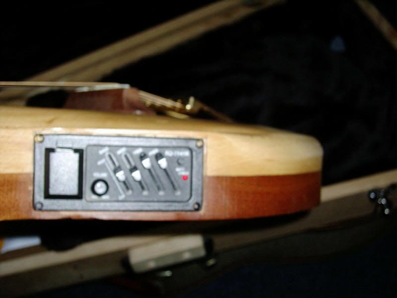

Theres a piezo under the saddle which runs to this badly fitted preamp. I carved this top edge round after I'd been playing it for a month. Strumming over that sharp edge hurt a bit!!
And the headstock. Yes, I know the tuners are too close, too high, but I drilled the holes before I finished the back of the neck. (I'm learning here folks, learning!!)

Martin, I think its a cool concept. How does it sound? What would you do different if you were to make another one?
PostPosted: Sun Sep 17, 2006 12:42 am
Martin, that is very strange. I really like the creativity of it, and I'm sure no one has another like it. I like it. Does it sound anything like an acoustic or is it more like a hollow body electric in tone?

If I were to make one, I'd make the body a little bigger, thus more space in the chamber..perhaps a grilled soundport in the side top bout too...Sam Price38977.4521180556

If I were to do it again?
I'd arch the top properly, and not have just the tiny little teardrop shaped soundboard.
I'd slender down the neck a little
I'd put the same headstock as my other builds have, and sort out the tuner layout.
I'd spend a LOAD more time on the shaping and finish.
Don't think I'd go to a full archtop wih bent sides. I like the fact that this is as ogh as a tough thing with a leather jacket and a flick knife.
I'd MAYBE go for a LR Baggs Tunomatic piezo bridge rather than the bone saddle & piezo.
Oh yes, and I'd get the dimensions sirht so it'd fit in a LP shaped case
